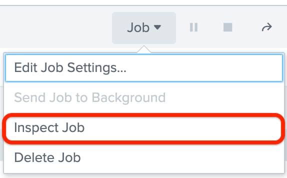

A useful tool for inspecting search execution is the Search Job Inspector. This time, we will use this tool to investigate the results of search job execution. The Search Job Inspector can be launched by selecting "Jobs" - "Inspect Jobs" after running a search.
Alternatively, you can start the process by selecting "Activity" - "Jobs" from the menu bar, and then selecting "Actions" - "Jobs" - "Investigate Job" for the job you want to investigate.
[Starting from "Jobs" after performing a search]

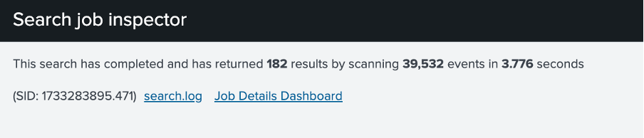

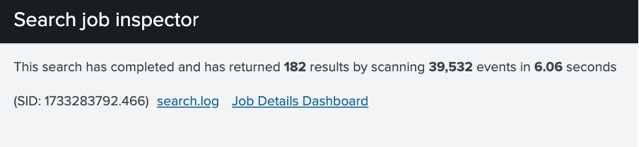

When you launch Search Job Inspector, the search results will be displayed at the top.This bar shows you the number of results your search returned, the number of events scanned when you ran the search, and the time it took.
Search job results for [Case 1]
Search job results for [Case 2]
As you can see from the above, [Search 1] took 1.6 times longer. (However, search times may vary slightly depending on execution timing.)

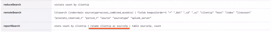

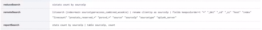

The Search Job Inspector also gives you other information that can help you make your search jobs more efficient. By looking at the "Search Job Properties" in the search job results, you can see how Splunk interpreted the SPL you specified and the actual search that was performed.
Search job properties for [Case 1]
Search job properties for [Case 2]
remoteSearch represents a search performed on a remote server, i.e. the Indexer, from the perspective of the Search Head. reportSearch is a search performed by the Search Head itself. As can be seen above, in Case 1, the Search Head performs the process of “renaming clientip as sourceIp”, which indicates that the amount of processing performed by the Search Head is large.
