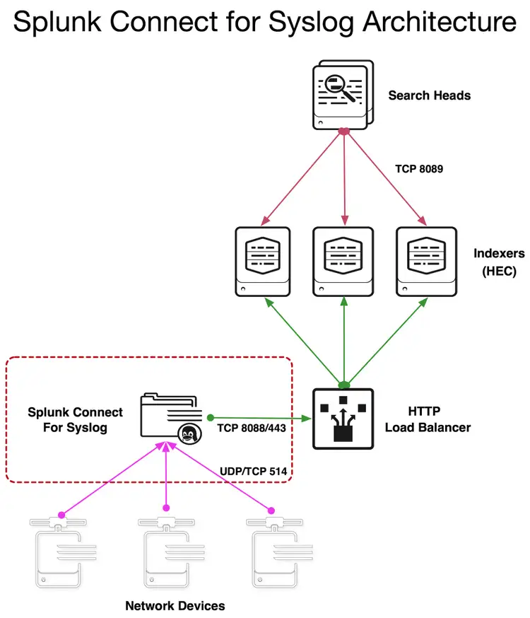

To realize the above benefits, SC4S is offered in two flavors: An OCI-compliant container for ease of deployment and OOTB functionality, and a “Bring Your own Environment” (BYOE) option for maximum flexibility at the expense of some turnkey features. Each environment is based on syslog-ng server software and encapsulates the same set of syslog-ng server configurations, while differing on the details of how syslog-ng itself is instantiated. Each utilizes the following high-level architecture:
Here are the highlights of each distribution:
Container
BYOE
In each distribution, the underlying syslog-ng configuration is identical; the differences between container/BYOE lie solely in the customer’s preference (and limitations) as to runtime environments. Moreover, a customer utilizing a “BYOE” environment can build a custom container that includes local config elements, which would then be suitable for edge distribution by automated orchestration.
